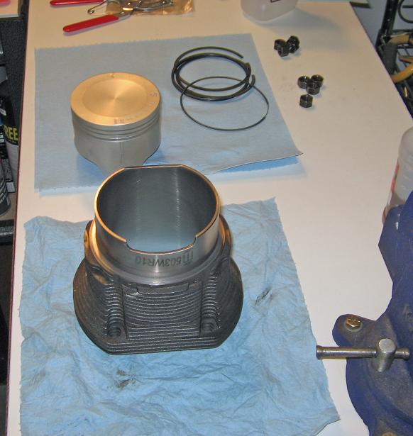

I have got to spend a few hours on the engine today, and was able to "right" my "wrong" from last week, when I installed the cylinder heads on the wrong sides. I feel much better now... So here are some pictures from last week and today.

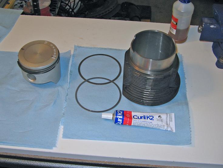

I had removed the piston rings before I mocked up the pistons, cylinders and cylinder heads for deck height. Prior to reinstalling them, I cleaned up the pistons and cylinders with a combo of carb cleaner, alcohol, lint free wipes, and compressed air. As everyone says, don't assume that the parts are clean from the factory. I got a lot of black residue off the cylinder walls. After I had reinstalled the rings, I installed the pistons in the cylinders. Sorry, no picture of the pistons going into the cylinders, but I did it as Jake describes in his video. Make sure not to push the piston in too hard when installing it in the cylinders. It took me the first piston to get the technique down for the ring compressor. Once I figured that out, the pistons went in with just a light tap on the top of the piston with the end of a plastic hammer handle. Although the pictures show the cylinder with the beveled edge up, I installed the piston into the other end of the cylinder.
I used two spacers at the base of each cylinder and put a thin coating of Curil K2 between each spacer and at the base of each cylinder.
