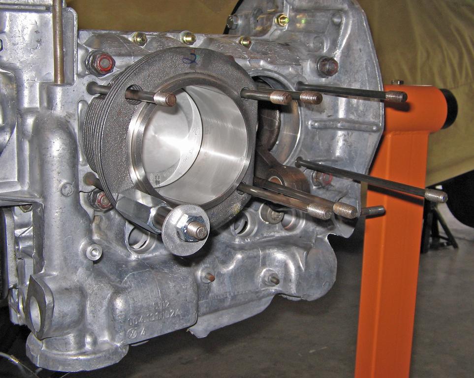

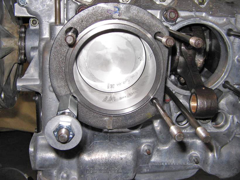

And on went the cylinders. It was easy to install the #3 piston pin since I had cut part of my engine stand mount away. Just make sure as you install the pistons that you don't pull back on the cylinders and expose the rings. That would mean back to the bench to reinstall the pistons with the ring compressor.

MrKona   And on went the cylinders. It was easy to install ...   Jun 1 2008, 01:54 AM
MrKona   Pistons/Cylinders...   Jun 1 2008, 01:55 AM
