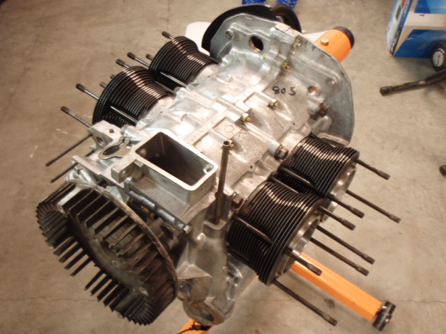

MrKona   I have got to spend a few hours on the engine toda...   Jun 1 2008, 01:47 AM

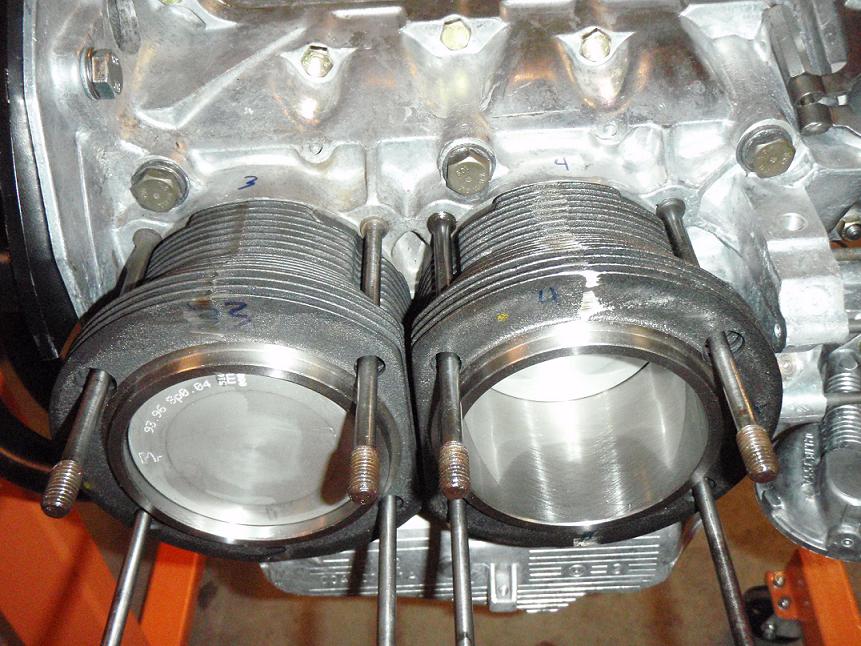

MrKona   And on went the cylinders. It was easy to install ...   Jun 1 2008, 01:54 AM
MrKona   Pistons/Cylinders...   Jun 1 2008, 01:55 AM
