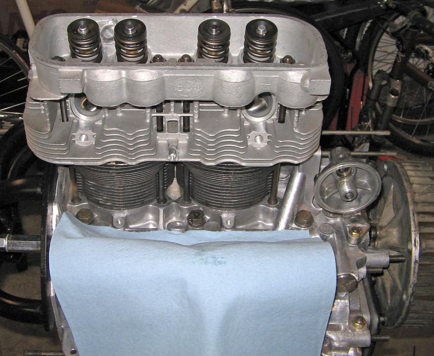

Next up was the installation of the cylinder heads, making damn sure that the head with the cylinder head temp sensor threaded hole is on the passenger side...
I torqued the heads in a criss-cross pattern, as illustrated on page 135 of Tom Wilson's book. I also followed his advice for the torquing of both heads:
1. Head one to 15 ft/lb, then head two to 15 ft/lb.
2. Head one to 20 ft/lb, then head two to 23 ft/lb.
3. Head one to 23 ft/lb, retorque head two to 23 ft/lb.
4. Wait a couple minutes retorque both heads to 23 ft/lb.

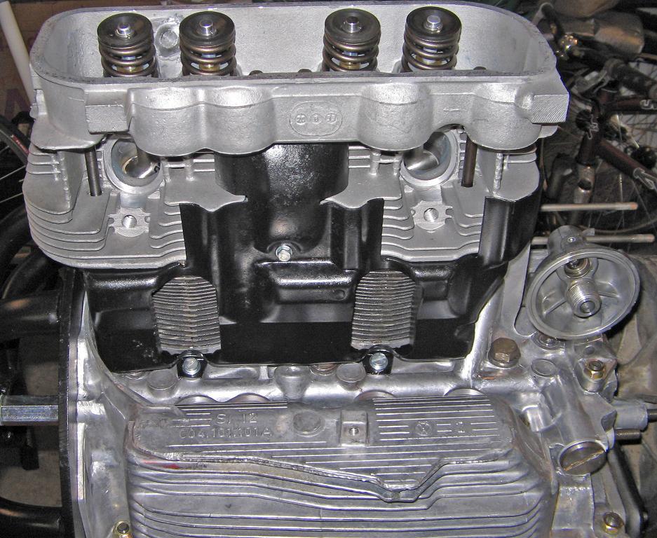

The next thing to go on after the heads are the under-cylinder tins. These need to go on before the pushrod tubes. I had these chemically cleaned at the metal cleaner when I had my case done. They came back nice and clean, but a little rough. I primed and painted them. I'm sure it will all burn off the first time I drive the car, but at least it looks nice during assembly... If I had been planning this better, I would have had them professionally coated and waiting for installation.
I kept a paper towel tucked under the cylinder tin as I installed the fasteners. Last thing I wanted was to drop one and have it fall into the case.
