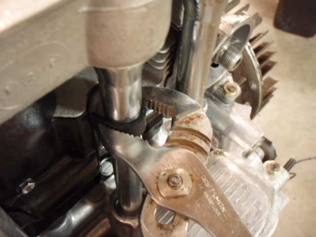

Next was the pushrod tube installation. As everyone advocates, I used clean motor oil and nothing else on the pushrod seals. They went in fairly easily. There's no way I could install the tubes with my hands in the cramped space, so I carefully used large pliers. I cut apart a vacuum cleaner rubber belt and placed a piece of it under the plier's jaws so as not to damage the tube, and also to get a better grip on the tube. Just make sure the outer tube is clean, so you don't have to squeeze too tightly to get a good grip. Twist and push, and they sank right into their recess. I made sure to put a couple drops of oil in the case recesses to prevent damaging a seal.

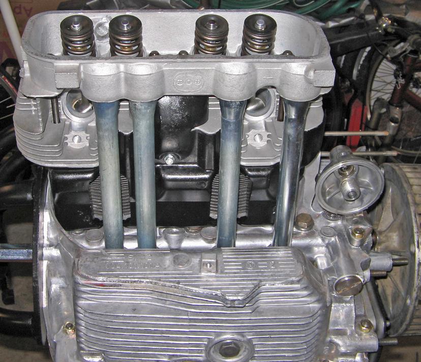

MrKona   Next up was the installation of the cylinder heads...   Jun 1 2008, 02:06 AM
MrKona   Next was the pushrod tube installation. As everyon...   Jun 1 2008, 02:12 AM
MrKona   And that's all for tonight!   Jun 1 2008, 02:16 AM
