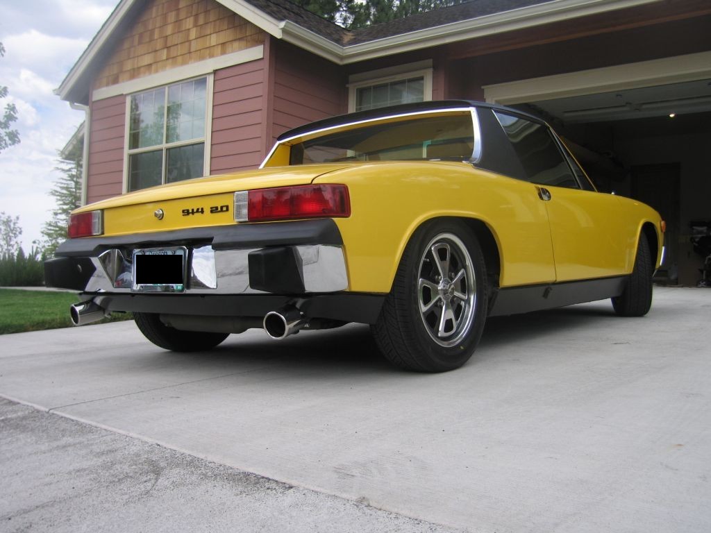

Lavanaut   Went and picked up the car today. Check out the p...   Jun 5 2008, 01:50 PM

Lavanaut   One more, just for kicks. :wub:   Jun 5 2008, 01:51 PM
