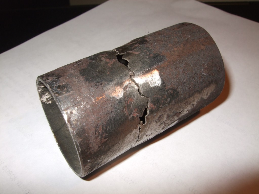

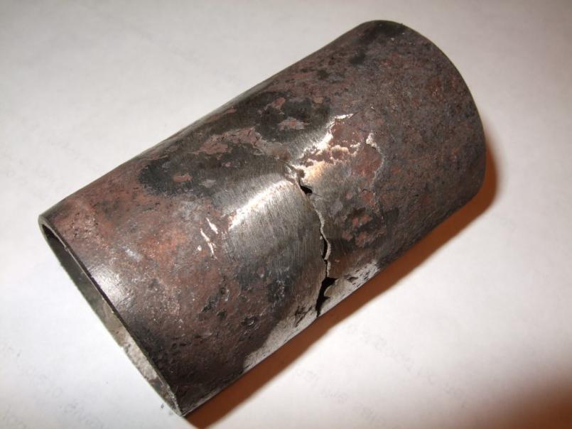

Went and picked up the car today. Check out the pics of the section of pipe removed/replaced that was inside the heat shield. Crazy! This was obviously not a split at the seam formed when the pipe was rolled. I'm having a hard time wrapping my mind around how this could happen. (IMG:style_emoticons/default/blink.gif) That crack goes 270 degrees around the circumference of the pipe.
Driving the car home from the shop today was an eye opener. First thing I noticed was, well, no exhaust pouring into the cabin. That's a nice feature. Next thing I noticed was the sound...wow. Even with the leak the car sounded great in my opinion (not including the popping on decel). But man now it sounds just that much better. A much nicer resonance, more of a growl and less throaty is how I'd describe it. My wife followed me home from the shop and when she got out of our truck when we got home she said, "damn the car sounds sweet!" (she's a keeper (IMG:style_emoticons/default/smile.gif)). But the most rewarding part of this little 10 minute drive was just that...the drive itself. Very simply put, the throttle response was noticeably more precise. I don't fully understand the negative effects an exhaust leak can have on our little cars, but for those of you that do, does it make sense that it would drive better? I swear...and I don't think I'm imagining it...it seems a tad bit quicker as well. (IMG:style_emoticons/default/confused24.gif)
It's funny - I hadn't realized just how much the exahust leak issue had soured me on this car. Always having to drive with the windows down, popping every time I'd downshift or let off the accelerator at high RPM...kind of just sounds like no more than just a small annoyance. But now that it's fixed, well, I realize that it was more than an annoyance. It pretty much made me not want to drive the car at all. I can't believe how much I enjoyed the ride home from the shop today! I guess it was the first time I've ever actually driven my car with a properly functioning Triad/SSI combo...and it now comes HIGHLY recommended by me. (IMG:style_emoticons/default/aktion035.gif)
Enough rambling, on to the pics. Thanks all for your input, it helped.

QUOTE(Lavanaut @ Jun 5 2008, 11:50 AM) *
stress crack ... maybe the car was run without a muffler hanger for a extended period of time ...

QUOTE(SirAndy @ Jun 5 2008, 01:19 PM) *
(IMG:style_emoticons/default/idea.gif) Andy
i'd bet an explosion (IMG:style_emoticons/default/blowup.gif) . too much fuel + trapped in heat = (IMG:style_emoticons/default/blowup.gif)
besides it looks puckered out

TeenerTim   That's a huge amount rust for a stainless pipe...   Jun 5 2008, 02:54 PM
6freak   That's a huge amount rust for a stainless pip...   Jun 5 2008, 03:34 PM
SirAndy   That's a huge amount rust for a stainless pip...   Jun 10 2008, 01:23 PM

Marty Yeoman   Nice hole!! I knew Shayne would take good...   Jun 5 2008, 02:27 PM
Lavanaut   In just one of the pipes though? It seems like i...   Jun 5 2008, 02:32 PM
6freak   In just one of the pipes though? It seems like ...   Jun 5 2008, 02:47 PM
