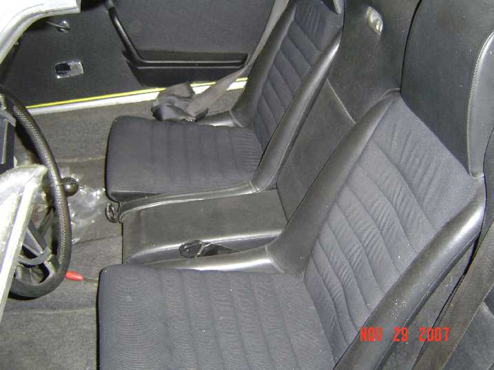

So if I'm not mistaken, the interior of the '70 Sixes were a flavor of basketweave (the door panels, seat inserts, etc.) and the '71s and '72s had the leather look, smooth finish. Is this correct?
mel reckling
post Jun 12 2008, 01:23 PM
Posts: 107
Joined: 28-November 07
From: north royalton, ohio
Member No.: 8,385
QUOTE(Lavanaut @ Jun 11 2008, 08:20 PM) *
Except for when they're cloth inserts like this.
The door panels aren't smooth either.
