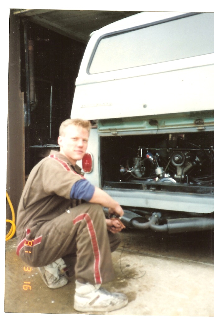

Here's the first one. It was in a 64 Kombi. I put in a bus boys select a drop and eliminated the reduction boxes. This one I bunny hopped in front of the house and broke an axle. My friends told me when I stomped on it the rear tire came off the ground a foot. You can see the cheesy carb linkage. I learned that you needed to spend some money on a decent linkage to keep the carbs sync'd.
