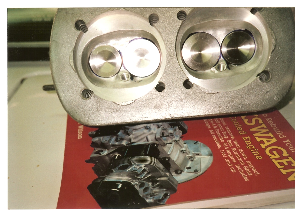

jmill   I've built 2 1914's. They're the best...   Jul 5 2008, 11:35 PM
Jake Raby   The 1914 is my favorite TI.. 95% of the engines I ...   Jul 5 2008, 11:44 PM
jmill   Here's the first one. It was in a 64 Kombi. ...   Jul 5 2008, 11:57 PM
