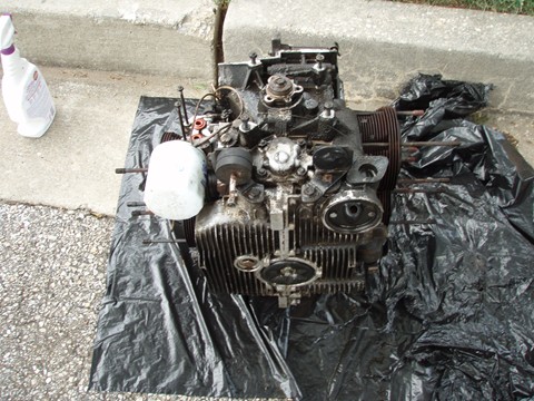

And...we're off!
The goal: Build a 2056 from a 1.8L jet. We'll use the 1.8 Case and Heads, new 96mm P&C's, Raby Cam & Valvetrain kit, and, for the moment, put an Ljet or Djet back on it. Eventually it'll get dual carbs, but I can't drop the extra G just yet.
I'll include as manay pics as I can. I got a little ahead of the camera with this so the engine is already out of the car, the tranny and exhaust are off and these pics show the rats nest (Ljet, harness, vacuum), throttle body, intake runners and right side tin coming off.
Had to use the cell phone cam for these, future pics will be better.

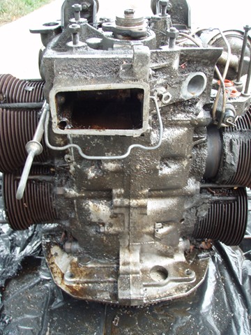

Other Misc pics.
Dirty
Attached ImageAttached Image

Rick L   Here's what many years under a tree w/o a rain...   May 13 2008, 06:23 PM

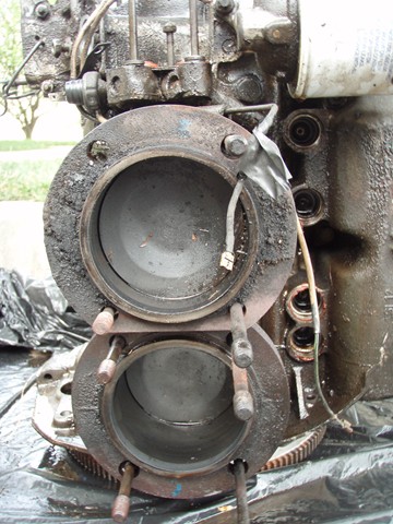

Rick L   Herb and I finally got the case cracked. 30 years...   Jul 6 2008, 07:20 PM
Rick L   Here are the p&c's: 1&2 3&4   Jul 6 2008, 08:01 PM
Rick L   The shims, spread so you can see all 4. And the...   Jul 6 2008, 08:08 PM

Jake Raby   If you haven't purchased the cam yet and you...   Jul 6 2008, 08:18 PM

Jake Raby   Excellent.. Thats an early EC engine.. It has the ...   Jul 6 2008, 08:27 PM
