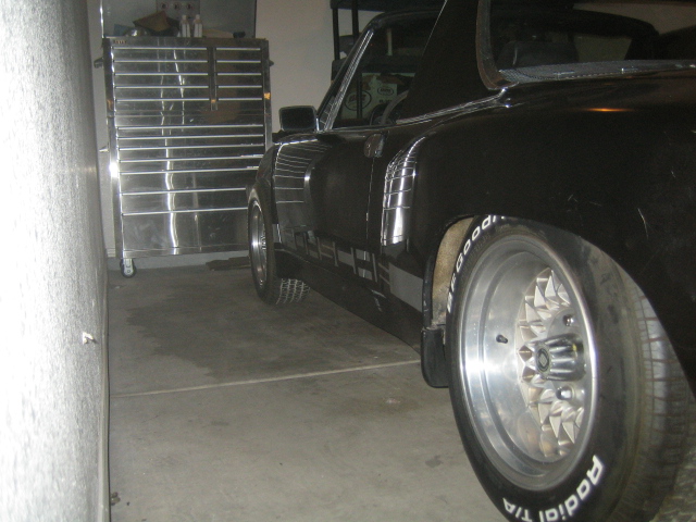

Advice from my experience. (on 3rd subie conversion) This time around i am using a US spec 2.5 liter Naturally aspirated engine with free flow intake, free flow exhaust to an extent (dont want to lose too much torque) and delta 2000 grind cams. The stock 2.5 n/a is a blast, this one should be killer too. Yeah if you plan on turboing it later i would recommend going with a closed block due to the head gasket failure porblem when under boost. The STI motor has lower compression pistons so when under boost it wont detonate. But the standard 2.5 n/a motor can handle some boost to bring it up another 35 horsepower if needed in the future. (5 lbs or less boost) As long as you have a free standing computer like my setup (link computer) and you can monitor from your wideband o2 sensor at ALL rpms and loads (dynoed) then you should be fine. (ex. larger fuel injectors with turbo, programmable fuel going into cylinders,etc)
I'll release my dynoed numbers after this conversion....should be nice. (IMG:style_emoticons/default/popcorn[1].gif)
stay tuned should be done by end of august with this one!
