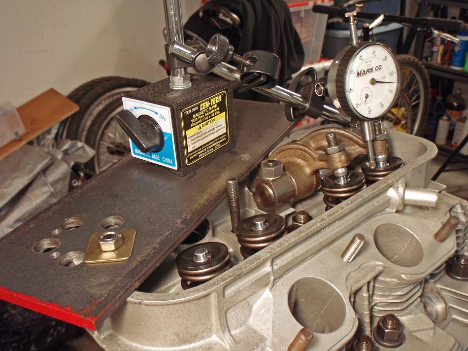

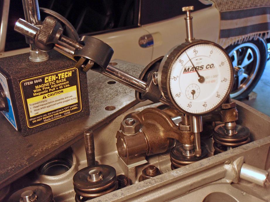

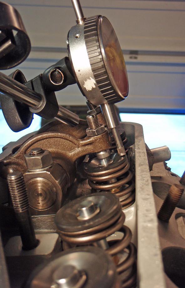

It's been awhile since I posted any progress. By no means have I lost interest in this project. Just some delays due to competing priorities... sound familiar? The engine has been sitting under plastic in the garage, waiting for me to work on it again. I set up the valvetrain geometry this weekend. I've read Jakes article many times, and searched on this site for some great information. I used an adjustable pushrod to calculate all the pushrod lengths for each valve, and have cut four. I started getting a little fatigued earlier tonight so I figured it was time to call it a night.
A couple details:
Solid spacers and swivel head adjusters. I sanded down some of the adjusters with very fine sand paper as some of the rockers fit pretty tight when first mocked the assemblies on the case. I've got them so they rock smoothly with no side to side play.
Steel pushrods. I cut them with a small pipe cutter and finished off with a grinder, deburred with a small file. Blew them clean with carb cleaner and compressed air. I had two old lifters that I used to hold the ends while I tapped in the pushrod tip.
My set up, as you can see is just a steel plate (the piece I used as a crank holder earlier in the build). Worked great to mount the magnetic dial indicator stand.
All measurements at full lift are within +/- 5% lift specs for the 9550 cam. At half lift, the valves and adjusters are about as straight as I can possibly see: Assemble, measure, disassemble, adjust, reassemble, repeat...
