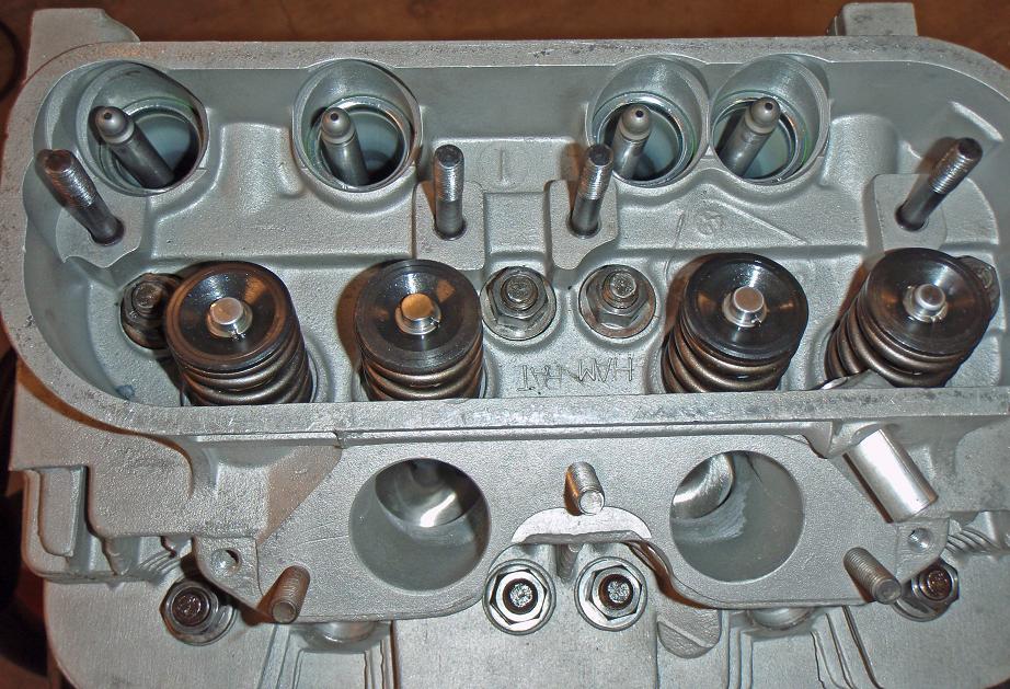

MrKona   Next up was the installation of the cylinder heads...   Jun 1 2008, 02:06 AM

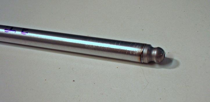

MrKona   Next was the pushrod tube installation. As everyon...   Jun 1 2008, 02:12 AM

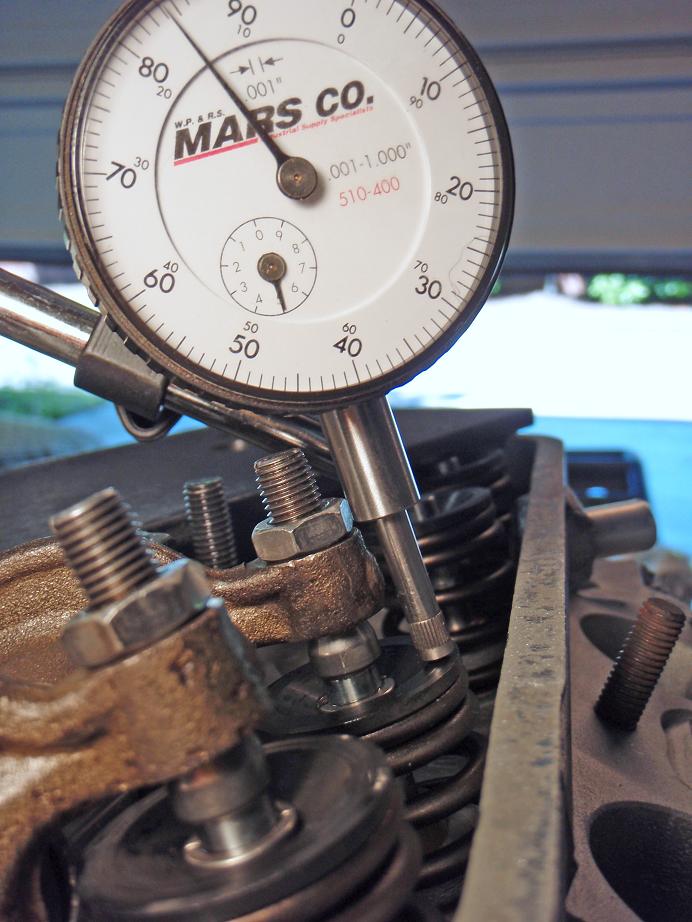

MrKona   Valves installed and adjusted. I've come as fa...   Aug 6 2008, 08:34 PM
