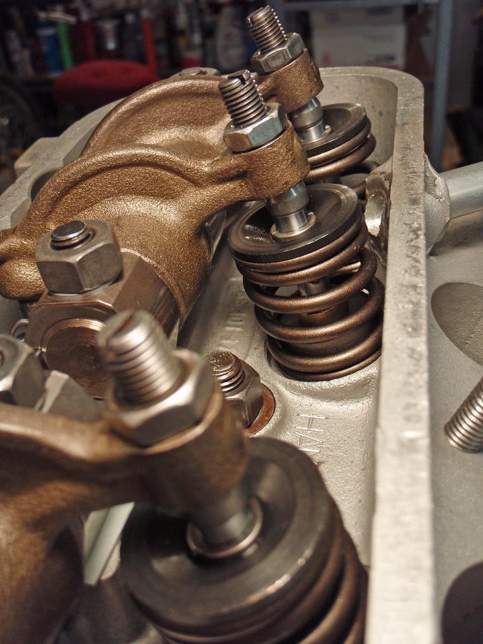

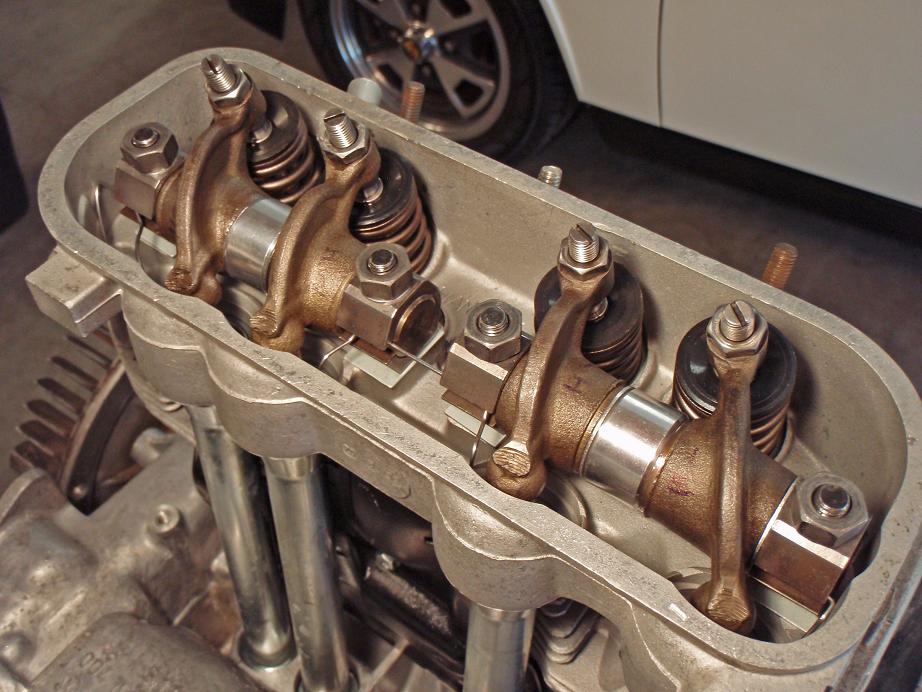

MrKona   Valves installed and adjusted. I've come as fa...   Aug 6 2008, 08:34 PM
