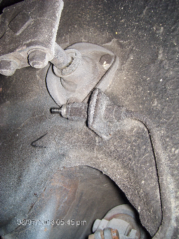

to summarize, SS line from PP doesn't fit. black hose from parts supplier also doesn't fit. turns out there is an adapter for each end of the old SS line. see pixAttached Image

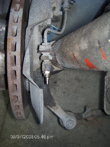

here is the other endAttached Image

jfort   to summarize, SS line from PP doesn't fit. bl...   Aug 7 2008, 06:12 PM

Phoenix 914-6GT   I have installed those same lines with no problem....   Aug 7 2008, 06:22 PM
jfort   yeh, it's weird. also, it looks like the two ...   Aug 7 2008, 06:32 PM
ArtechnikA   well - that's just whack... get some normal M...   Aug 7 2008, 06:55 PM
jfort   OK, you guys, I figured it out this morning at a b...   Aug 8 2008, 09:39 AM
Phoenix 914-6GT   :headbanger: Glad you figured it out. I wouldn...   Aug 8 2008, 02:00 PM
