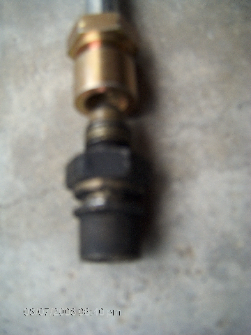

sorry for being so fuzzy. here is the original fitting. still won't fit into either the SS hose or the black hose. the diameter of the hose fitting is too small for the car/caliper fittings. don't know why what is in car differs from what suppliers expect. But, I found a place in Toledo that can make DOT hoses while you wait and they seem to have every fitting known to man. I will go there in the morning and hopefully get hoses that fit.

jfort   sorry for being so fuzzy. here is the original fi...   Aug 7 2008, 06:19 PM

jfort   OK, you guys, I figured it out this morning at a b...   Aug 8 2008, 09:39 AM
Phoenix 914-6GT   :headbanger: Glad you figured it out. I wouldn...   Aug 8 2008, 02:00 PM
jfort   they were shitty SS hoses. very thin couplings. ...   Aug 9 2008, 06:23 AM
