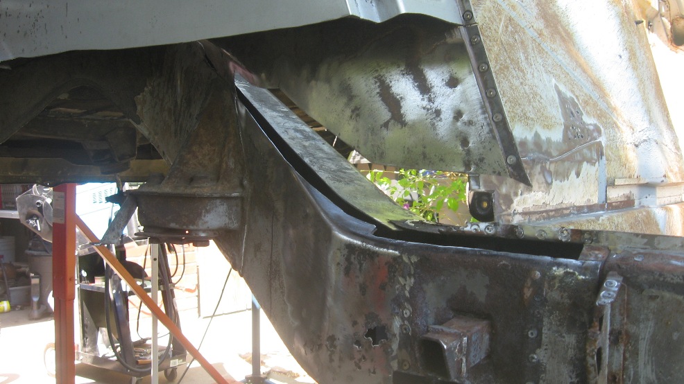

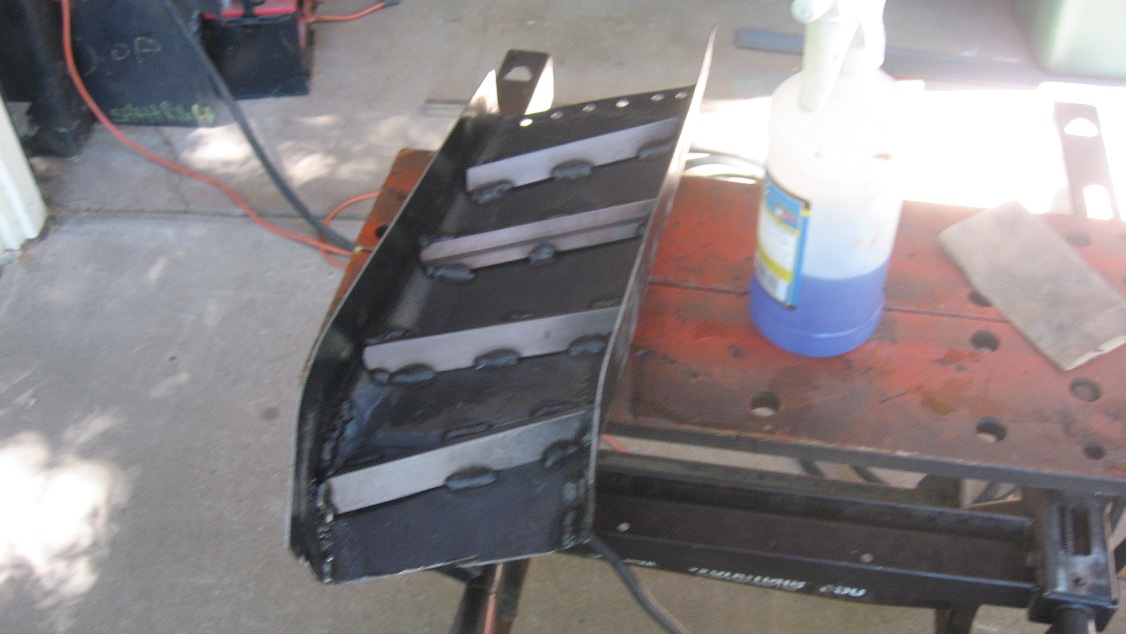

Next up is a pic of the patch piece, made of 16 gauge steel. Since the factory piece used inner "ribs," I added these reinforcements made of 1" 14 ga. square tubing ripped into angle pieces. This pic shows the Metal Prep stage, prior to painting the inside with gray POR15.
Since I'm using a rotisserie, I don't want to completely muck up the dimensions by cutting out too much at a time. So I'm replacing pieces in relatively small increments, and checking to see that the suspension jig I built still lines up as I go. Here is a pic of the patch during welding into the hole.
That piece will be covered with an 18 ga. outer shell, in order to attain the same thickness that the factory used (two pieces of 17 ga.). That outer shell will be welded in as soon as I provide a good foundation to weld. From a previous pic, you can see the "wall" has rusted out and portions need to be replaced -- and that area is necessary in order to install the "outer" shell.
Here is a pic of the area I've cut out to complete this next phase.
