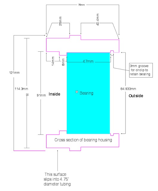

The problem is the wheels are 10 inches wide with an offset of 2 inches. In searching the web site it seems that most people with this combo have gone with 3" spacers. This seemed like it would put a lot of force on the bearing and I still would not have many other rear brake options. So.... I found some rear 928 hubs on ebay. the bearings are much larger: 85mm diameter and 47mm wide (versus stock 75mm diameter x 37mm long) and this would provide me with other 5 lug rear brake options. So off to the barn.
First, put a piece of 5 inch 1.25 inch wall DOM(Drawn Over Mandrel steel tubing) in the lathe.

Forgot to add this should anyone else be interested in making one. Truly the only critical dimensions are the bearing bore 84.933mm and bearing depth, ie depth of bearing pocket to back of circlip.
