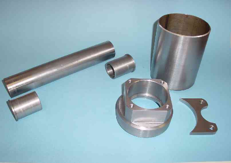

Few pics of a project I'm working on to break up the misery or paint, bondo and rust removal on my V-8 SBC conversion. I'm going to do the sheridan body work on my car and found these wheels which I liked.
The problem is the wheels are 10 inches wide with an offset of 2 inches. In searching the web site it seems that most people with this combo have gone with 3" spacers. This seemed like it would put a lot of force on the bearing and I still would not have many other rear brake options. So.... I found some rear 928 hubs on ebay. the bearings are much larger: 85mm diameter and 47mm wide (versus stock 75mm diameter x 37mm long) and this would provide me with other 5 lug rear brake options. So off to the barn.
First, put a piece of 5 inch 1.25 inch wall DOM(Drawn Over Mandrel steel tubing) in the lathe.

Nice work. Good to see someone thinking outside-the-box. I curious why you chose the 928 bearing? Most think the 914 bearing is more than adequate, and the 911 bearing beyond most needs.
I went with the 911 bearing mostly because it matched the late 911 axles, and I also moved the bearing further outboard in order to fit my 6 speed transaxle. Much like your work, here are a couple of photos of what I did (BTW, I can appreciate the amount of work that goes into this kind of thing). I fabricated a custom trailing arm.
