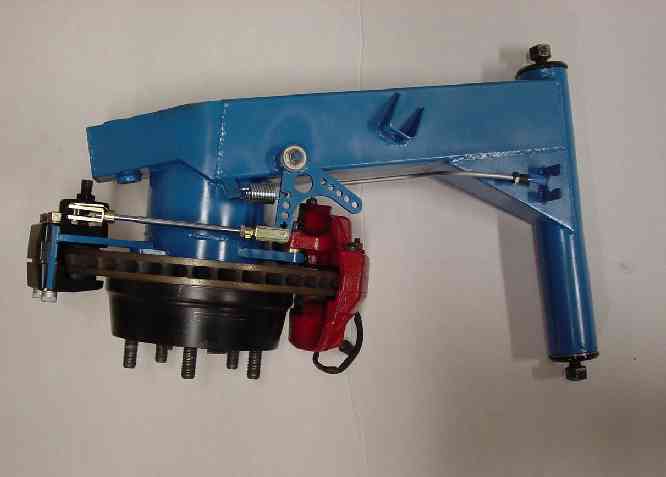

Few pics of a project I'm working on to break up the misery or paint, bondo and rust removal on my V-8 SBC conversion. I'm going to do the sheridan body work on my car and found these wheels which I liked.

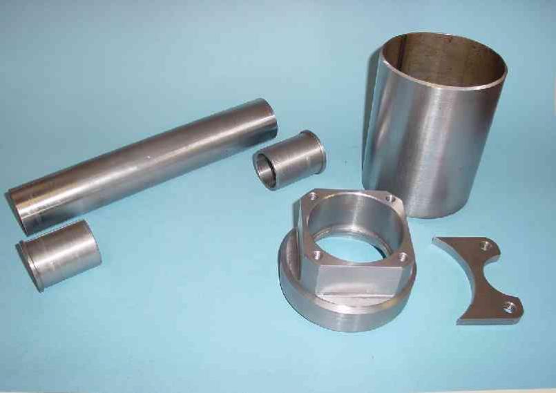

The problem is the wheels are 10 inches wide with an offset of 2 inches. In searching the web site it seems that most people with this combo have gone with 3" spacers. This seemed like it would put a lot of force on the bearing and I still would not have many other rear brake options. So.... I found some rear 928 hubs on ebay. the bearings are much larger: 85mm diameter and 47mm wide (versus stock 75mm diameter x 37mm long) and this would provide me with other 5 lug rear brake options. So off to the barn.
First, put a piece of 5 inch 1.25 inch wall DOM(Drawn Over Mandrel steel tubing) in the lathe.

Wilhelm,
Just catching up after 5 days in Puerto Vallarta, Mexico, thus the late post.
Nice work. Good to see someone thinking outside-the-box. I curious why you chose the 928 bearing? Most think the 914 bearing is more than adequate, and the 911 bearing beyond most needs.
I went with the 911 bearing mostly because it matched the late 911 axles, and I also moved the bearing further outboard in order to fit my 6 speed transaxle. Much like your work, here are a couple of photos of what I did (BTW, I can appreciate the amount of work that goes into this kind of thing). I fabricated a custom trailing arm.

From experience...
Junk the Wilwood spot caliper. If you set the brake when the rotor is hot, after it cools it won't release. You will end up beating the shit out of the caliper trying to get the park brake off.
