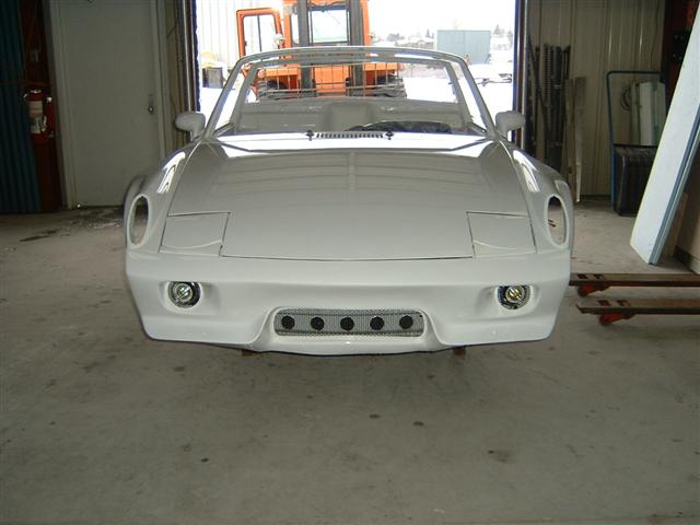

Any mid 90's Delta 88, (Pontiac Bonneville too I think).
Check out my thread, it was easy to do, cheap and look pretty good.
Olds Mirrors

tracks914   Any mid 90's Delta 88, (Pontiac Bonneville too...   Aug 21 2008, 06:51 PM
