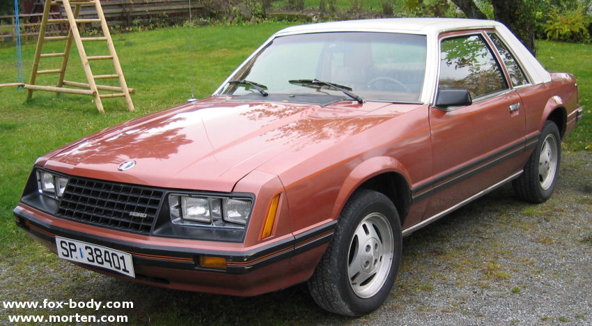

QUOTE(ArtechnikA @ Aug 26 2008, 05:02 AM) *
1) Wheels (e.g. 15", 16" ...)
remember in the early 80's the mustang gt's had a metric rim size between 14" & 15"? it was known as the "TRX" wheel. ONLY michelin produced a tire. i bought ALOT of used tires in those days! (IMG:style_emoticons/default/MDB2.gif)
