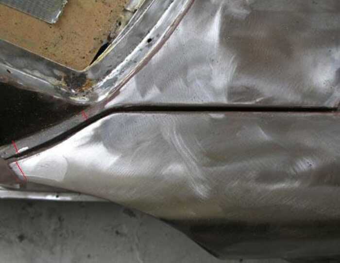

Early cars had a finished cowl to fender seam, no black rubber filler strip.

i don't think that's true for any of the production cars. i have seen that on some of the prototypes, but never on a production car ...

George is correct. Quoting from the factory bulletin: effective from 4702900444 and 9140430052 fender beadings are inserted between the fender and cowl
So this is not a difference between 914/4 and 914/6, only an early vs late instance.

It is very clear that my car 9140430041 has fender beading. So what is up with that?

The important difference is that the cowl and fenders were changed after 4702900444/9140430052 my car (914.043.0012) had the black bead in it but this was most likely done by the PO, 914.043.0011 is leaded.
I have attached 2 photo the red one is 914.043.0012. note the contour of the fender edge and the width between the a-pillar and the seam.

here is #41 marked up
