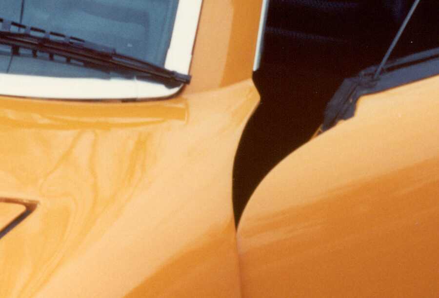

It is very clear that my car 9140430041 has fender beading. So what is up with that?
Bob BurtonAttached ImageAttached Image

The important difference is that the cowl and fenders were changed after 4702900444/9140430052 my car (914.043.0012) had the black bead in it but this was most likely done by the PO, 914.043.0011 is leaded.
I have attached 2 photo the red one is 914.043.0012. note the contour of the fender edge and the width between the a-pillar and the seam.

here is #41 marked up

Here is 914.043.0035 it had a filled seam
