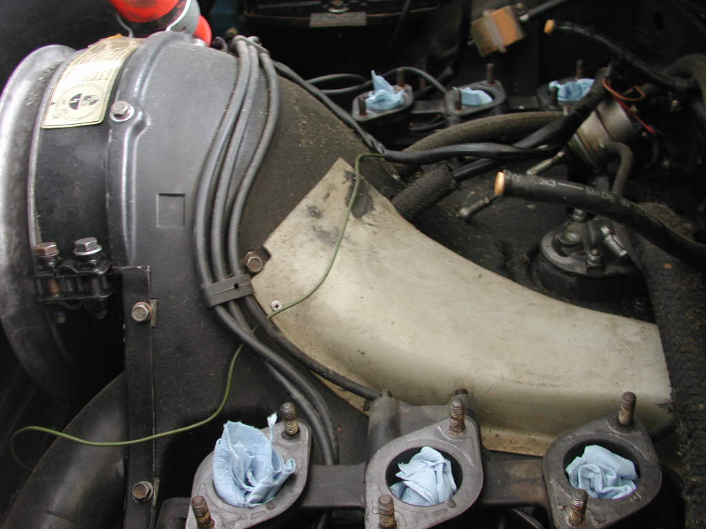

krk   Now it gets interesting. Most obvious things have ...   Jan 11 2004, 02:30 PM
krk   Now we unbolt all shroud bolts. Most are visible. ...   Jan 11 2004, 02:33 PM
krk   another angle.   Jan 11 2004, 02:33 PM
krk   Now, after disconnecting the fan belt, and unbolti...   Jan 11 2004, 02:35 PM
krk   Remove the nuts, and slide the diverter gadget bac...   Jan 11 2004, 02:37 PM
krk   And voila! The alternator, she is out!   Jan 11 2004, 02:38 PM

krk   So I took a couple of hours of this afternoon -- w...   Feb 10 2004, 06:29 PM
krk
  Feb 10 2004, 07:12 PM
Gint   You got it. It's a ground wire.   Feb 10 2004, 08:53 PM
