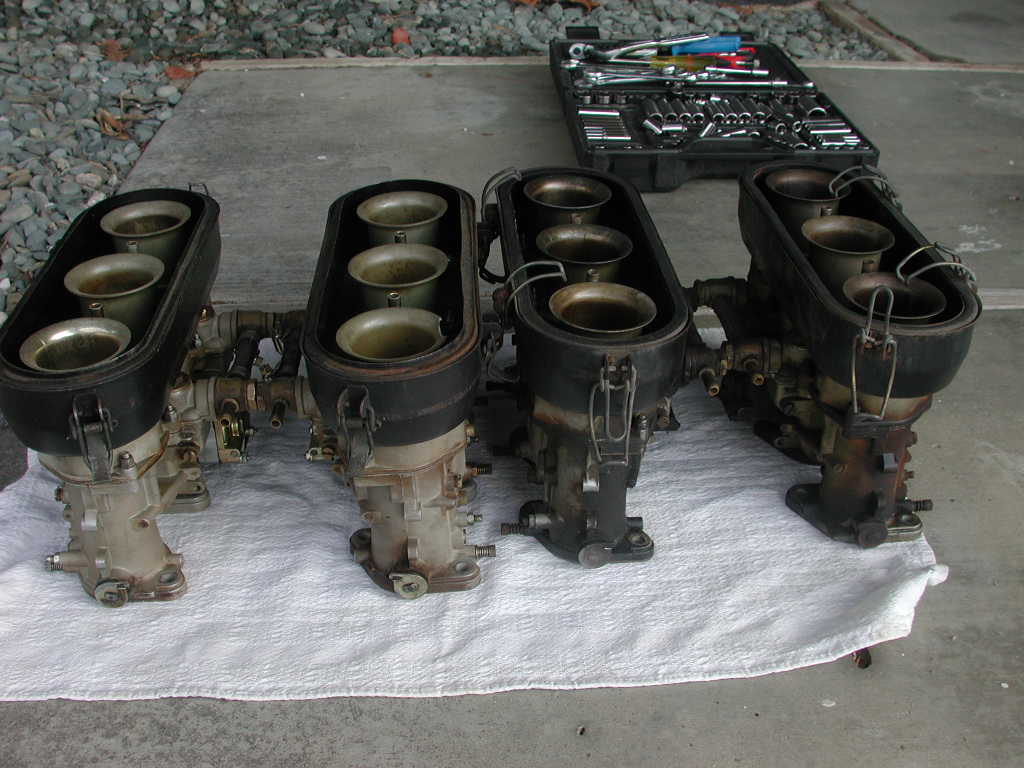

The clean carbs have worn throttle shafts.
The dirty ones do too, but much less so.

krk   Carbs out. [can't add the pic under edit? oh ...   Jan 11 2004, 02:20 PM
krk   carbs out.   Jan 11 2004, 02:22 PM
krk   sadfafsd   Jan 11 2004, 02:22 PM
krk   The clean carbs have worn throttle shafts. The di...   Jan 11 2004, 02:23 PM
