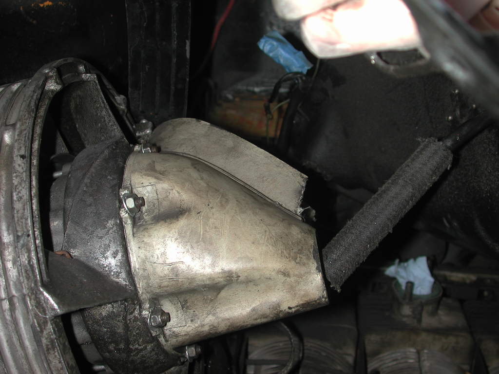

Now, after disconnecting the fan belt, and unbolting the retaining straps, the unit is movable, and you can see the nuts you have to remove to get at the back of the alternator.

krk   Now, after disconnecting the fan belt, and unbolti...   Jan 11 2004, 02:35 PM
krk   Remove the nuts, and slide the diverter gadget bac...   Jan 11 2004, 02:37 PM
krk   And voila! The alternator, she is out!   Jan 11 2004, 02:38 PM
