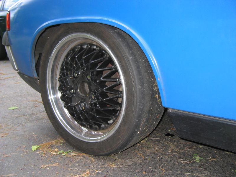

You don't have a choice for 7.25". (IMG:style_emoticons/default/biggrin.gif)
Yes, they are 7.25x16" 3-piece BBS (weird pieces
I found that make a great offset).
215/40/16 Kumho V710's. With normal tires,
these with 34mm offset would probably fit with
no mods. I folded up my lip, but remember that
the '70 cars did not have the 'thinner' lip like all
the later ones.
