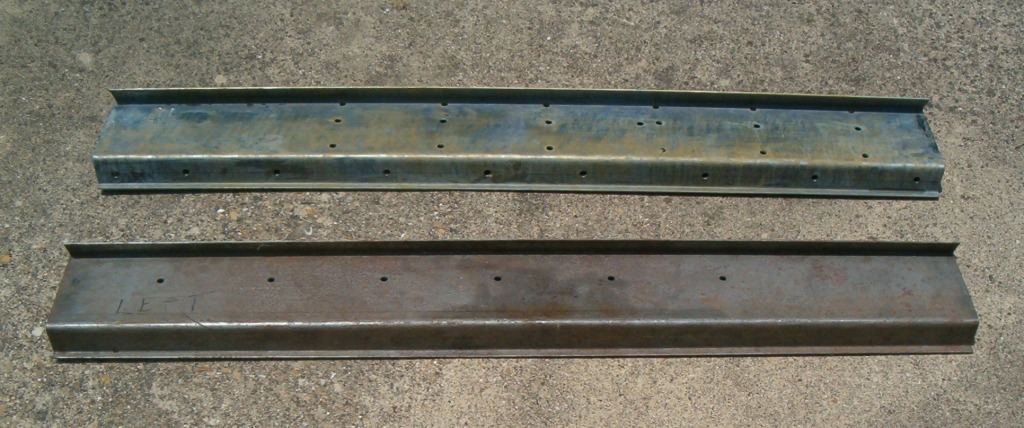

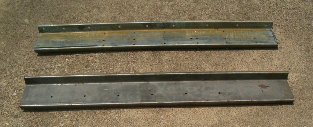

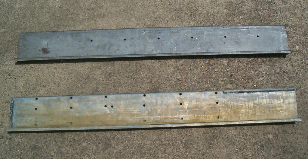

My alterations to the Brad Maurer kit...
The bottom long is how it came from Brad -
The top long is after I got done with them -
I added a signififcant number of holes for additional plug welds -
Including at the top to attach the sill plate -

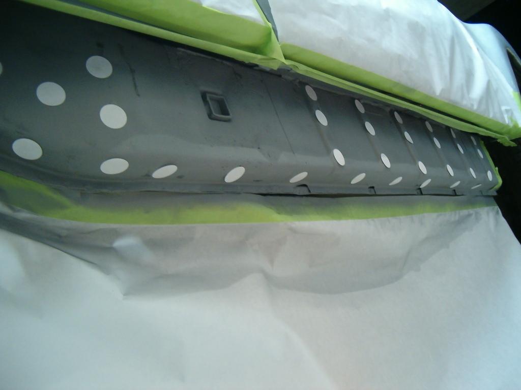

I found that the zinc weld through primer did not do a very good job of letting me weld through -
so I used a the little peel and stick dots to keep primer from the areas that were to receive the plug welds... (bottom)
