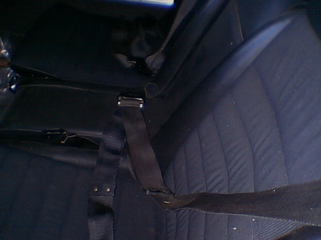

Seatbelts: non-retractable for all years 70 & 71, retractable for 72

Here's a shot, sorry it came out so bad.
