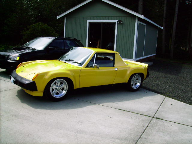

Front 8x16 225/50/ZR 16 Kumhos
Rear 10x16 265/45/ZR 16 "
CCLINROADRAGE
TC 914-8
post Oct 23 2008, 05:21 PM
Posts: 841
Joined: 23-May 08
From: Sequim, WA
Member No.: 9,090
QUOTE(boxstr @ Sep 23 2008, 10:26 PM) *
CCLINROADRAGE
Craig,
Too bad those wern't pollished Those 8's would fill in my front wheel wells just right. The 10's may be close in the rear, What's the offset on the 10's ? (IMG:style_emoticons/default/idea.gif) So far I'm stuck with 16X8 and 16X7
