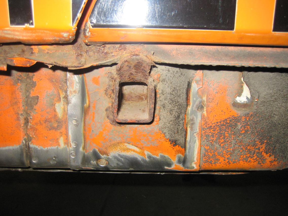

As you can see below the jacking posts were junk.

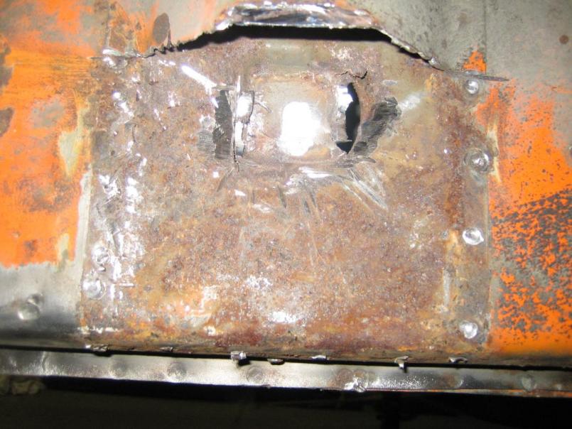

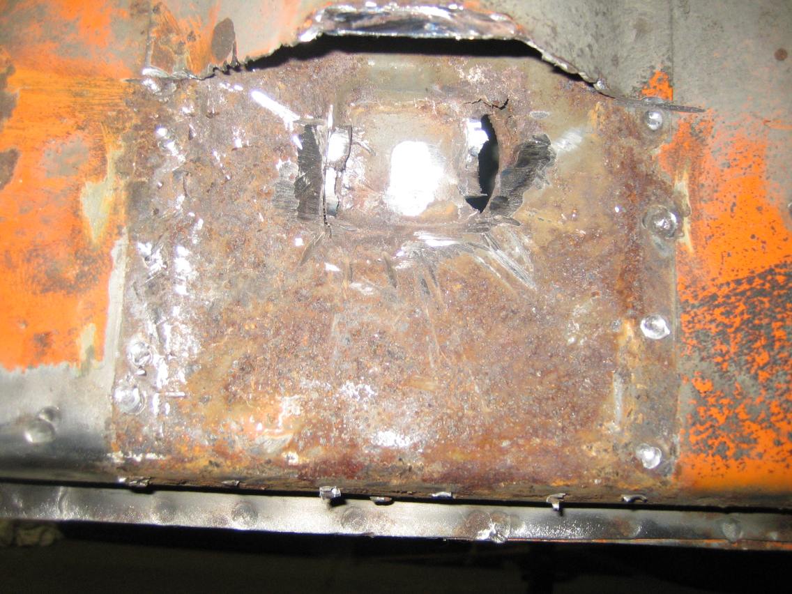

Here you can see the damage done, it had ripped and left holes in the long

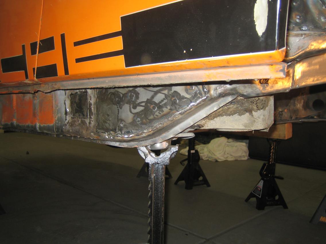

I actually bought the replacement parts but decided I would do the delete option instead. Here you can see I welded a plate over the old jack post area and the lower part of the GT kit fitted.
