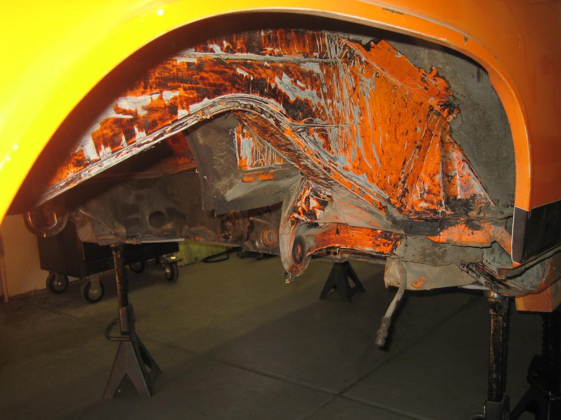

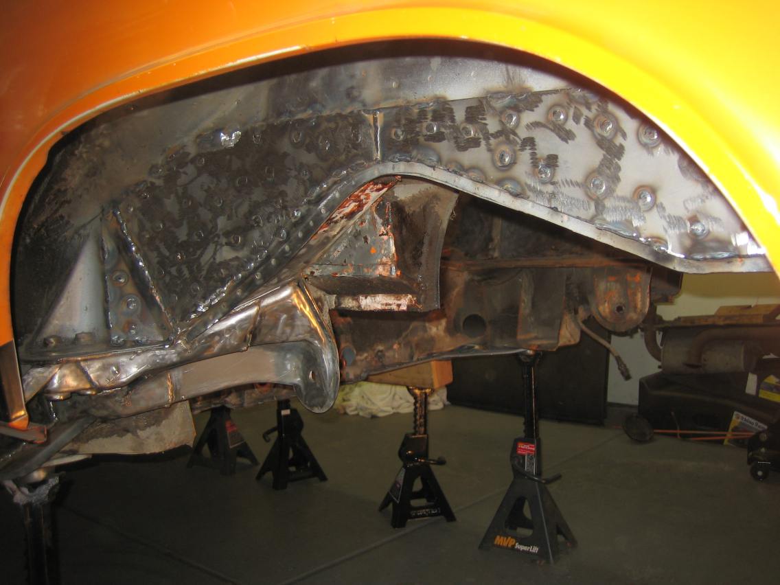

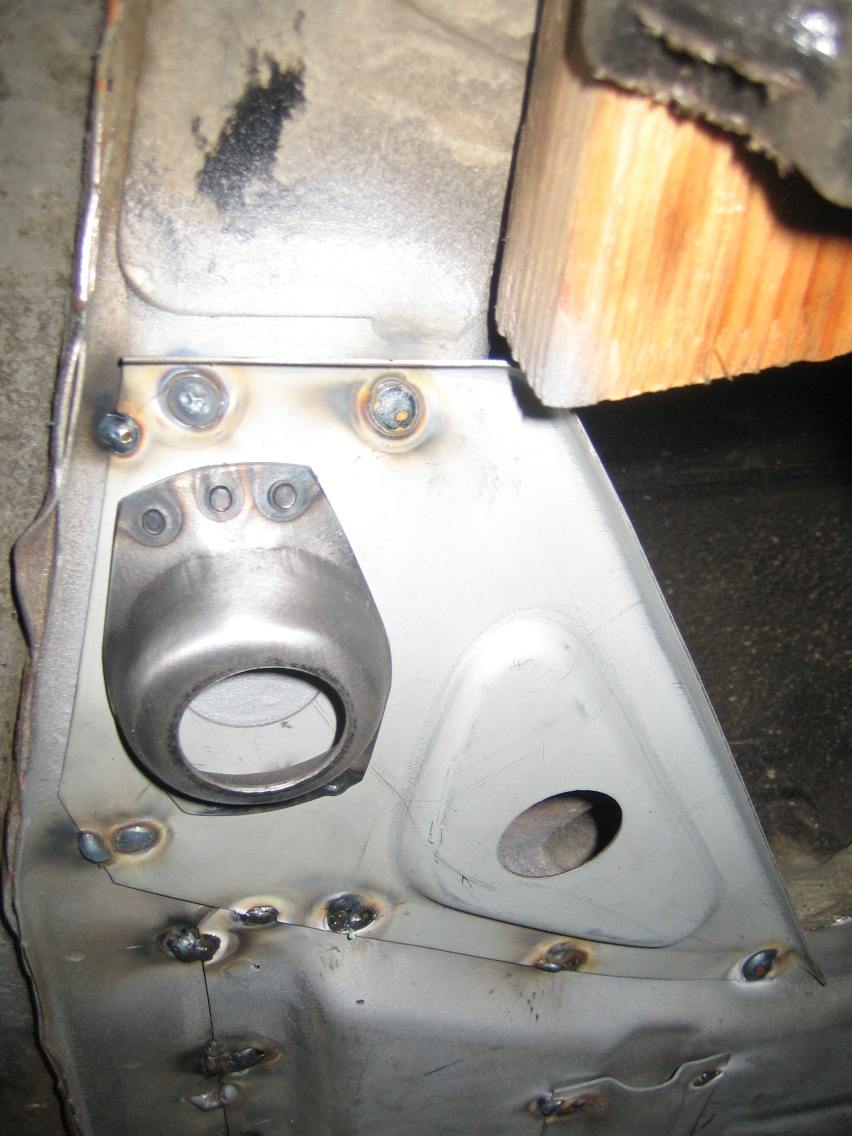

Two new rear jack points were welded in.
Here you can see prep for the passenger side for the GT stiffener kit, after scraping some citrus paint stripped does the rest.
Here is some welding complete on the drivers side.
Next is the rear stablalizer mounts and front stablalizer brackets.
