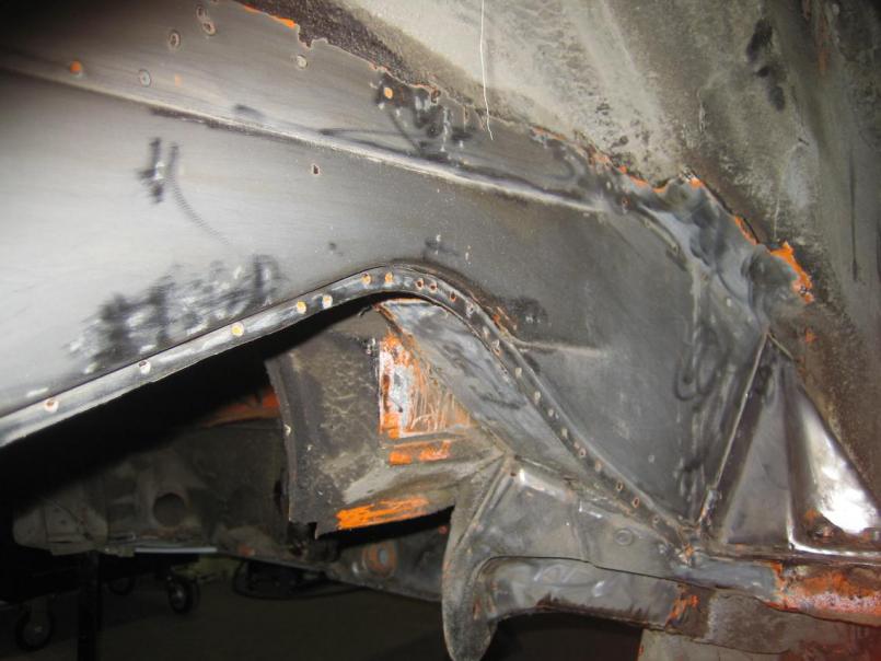

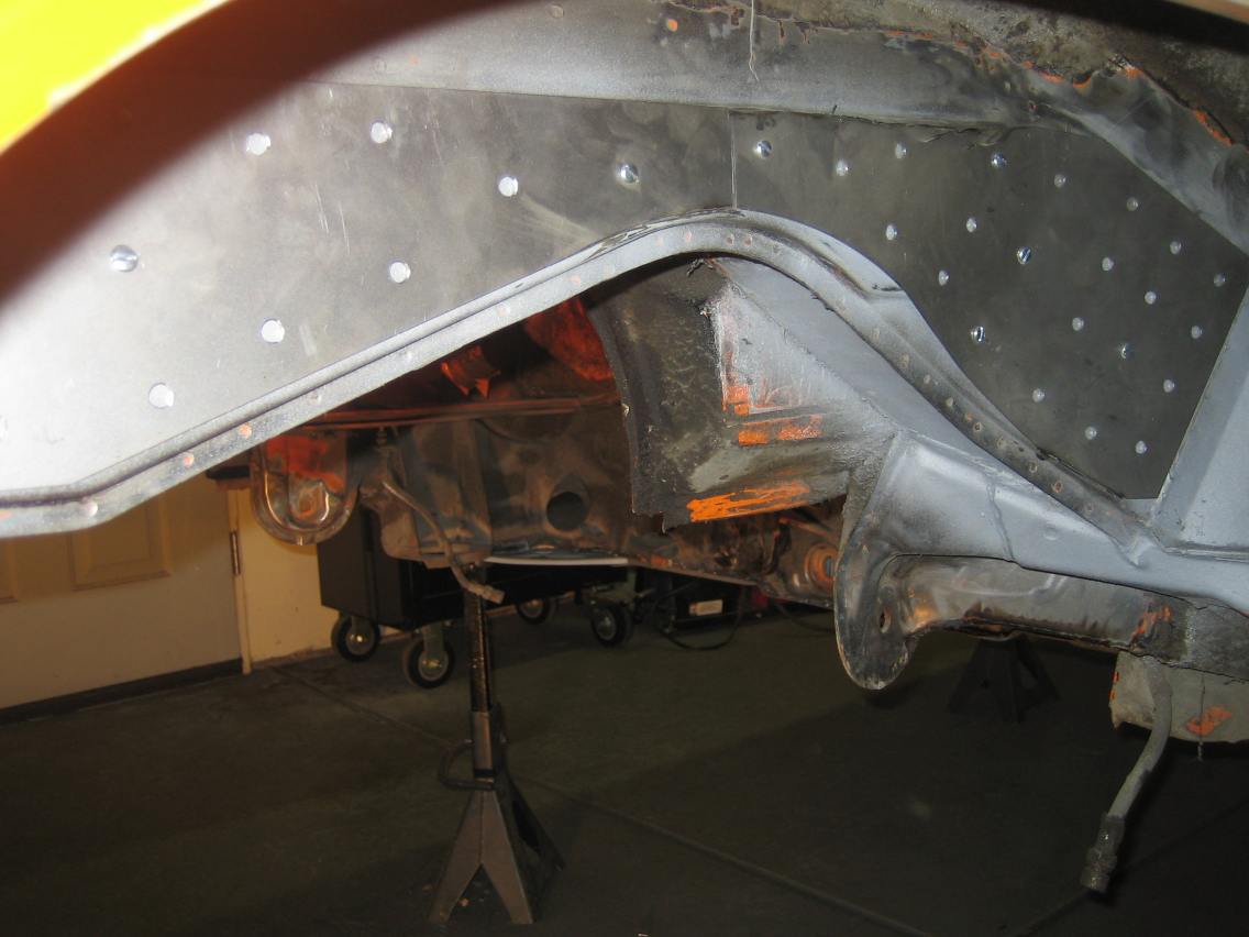

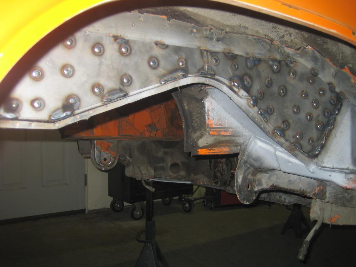

I thought I would add these photos of the passenger side of the GT kit, I put these two pieces on tonight and one thing I learnt from the drivers side is to use a few more screws to hold the pieces tight ... this made the whole process a lot easier.
Paint stripper worked great and the environmentaly friendly citrus fumes are not bad at all (IMG:style_emoticons/default/w00t.gif) honest.
Pieces attached with screws and I trimmed these two parts while fitted.
Would not have shown this pic when i started, my welds before use of the grinder, must have the welder dialed in about right for this job. Even the weld thru primer which sometimes gives me grief seemed to behave. There are a couple of ugly ones in there but its getting better ... honest.
One thing I am still working on is akward and tight angles, burnt quite a few holes in my socks because I had dripping welds trying to weld the piece that supports the suspension ear.
I will finish this side tomorrow and then onto the front sway bar mounts.
