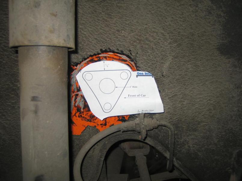

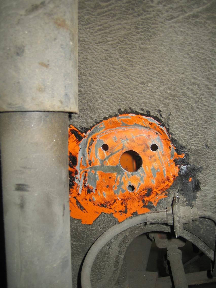

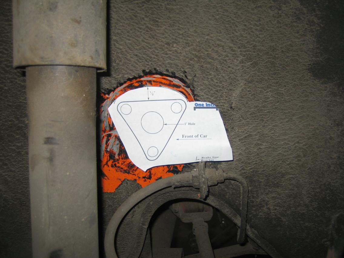

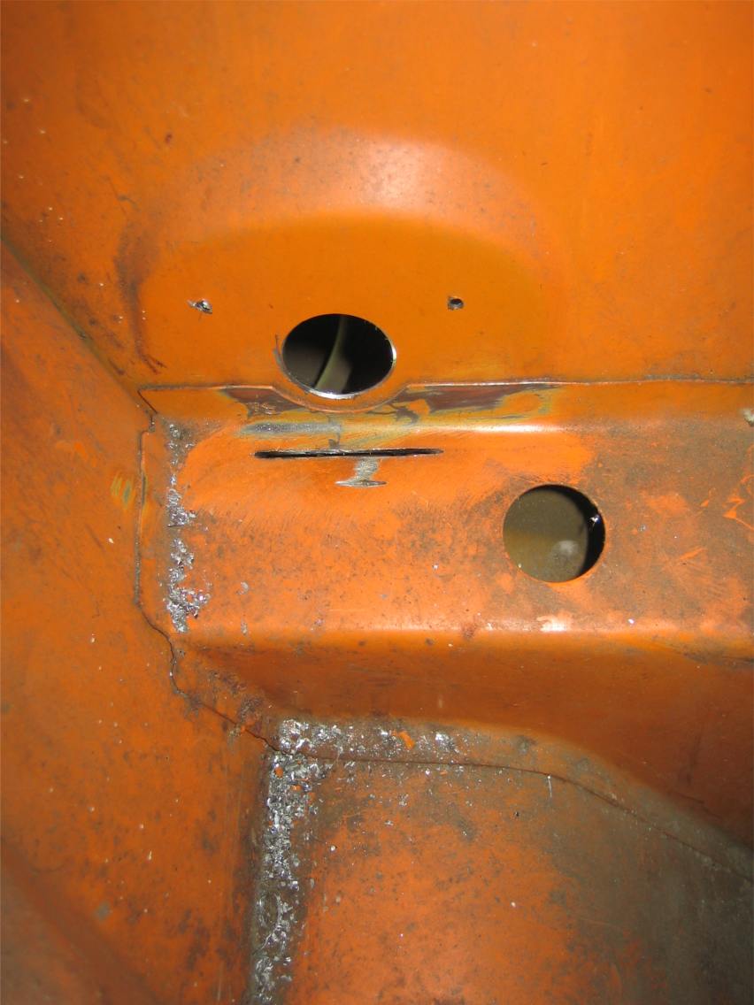

After removing the undercoating I printed the template from the Pelican write up and placed it as best as I could. The second side was more accurate (i.e. more level) but not too different. I then drilled pilot holes and the larger holes with one of those step drills.
Inside I cut the metal parallel and then find I ran out of those small dremel blades to do the rest. I decided to wait on welding the brackets in place till I actually get the stabalizer just incase something needs adjusting. Nothing worse than removing welded parts after you have put them on.

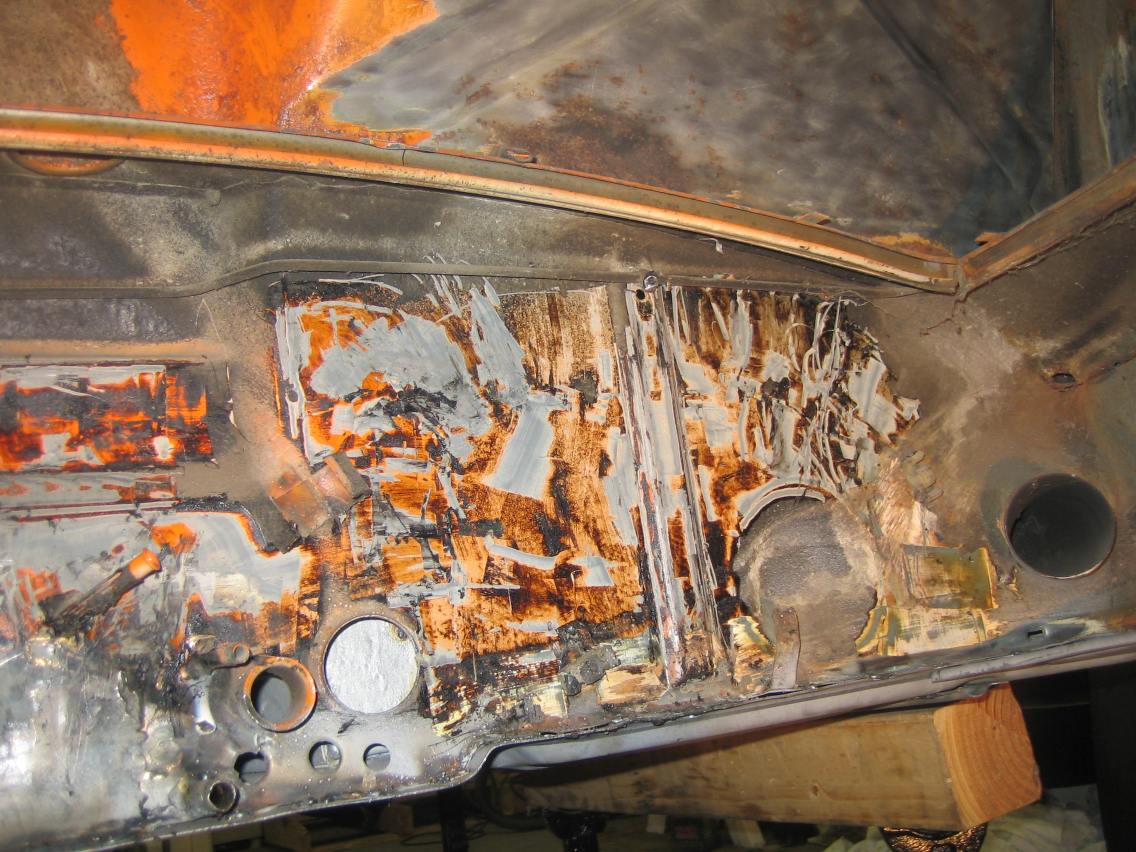

Next I started to remove some of the engine bay sheet metal which the Subie engine will not need, I was partly motivated to do this so I could get a better weld on part of the GT kit at the same time. While I was there I removed the underseal (getting better at it with the heat gun too) on the lower section and then got some paint stripper and cleaned it up.
