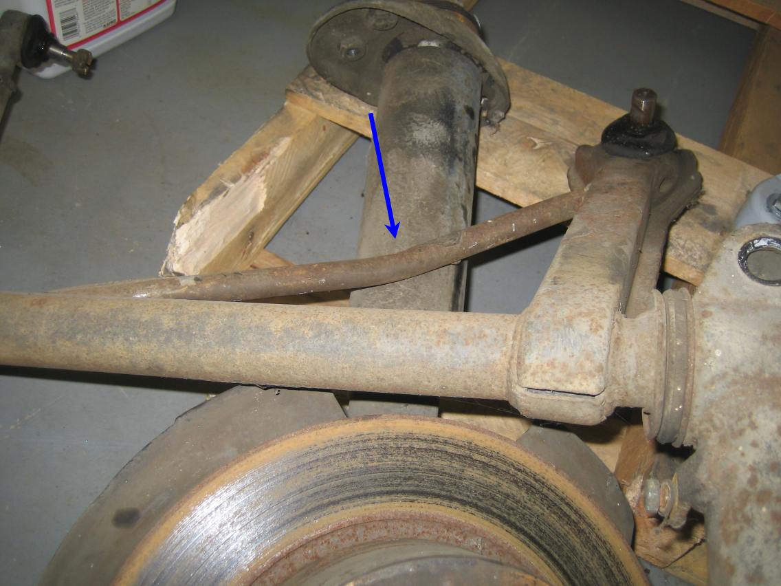

Last but not least I removed the front suspension, see where the bend on the control arm is? I think this was me (IMG:style_emoticons/default/headbang.gif) when I tied the car down on the trailer .... I think with the aid of a press I can straighten it out. Thoughts?

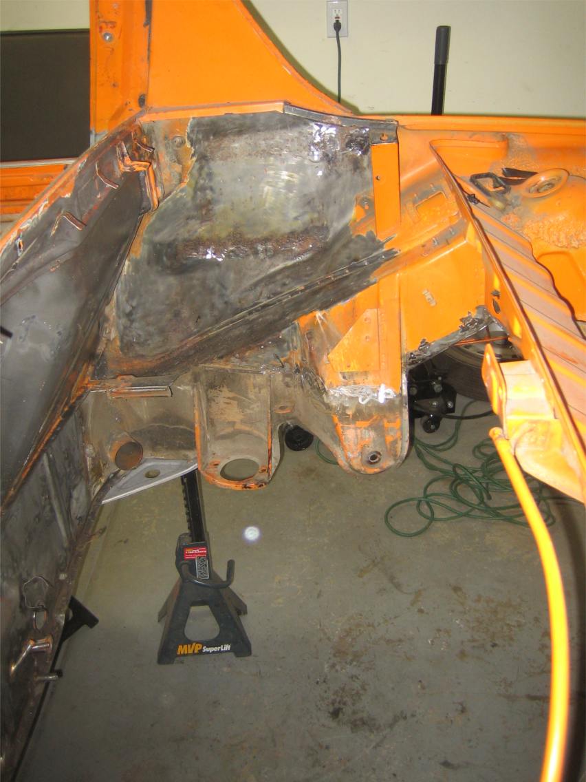

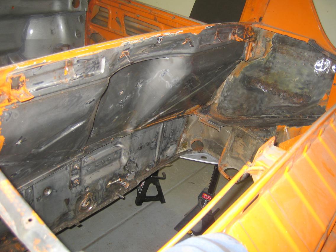

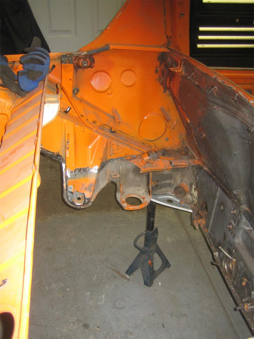

my928s4   After removing the undercoating I printed the temp...   Nov 2 2008, 06:36 PM
Todd Enlund   Last but not least I removed the front suspension...   Nov 29 2008, 02:34 PM
