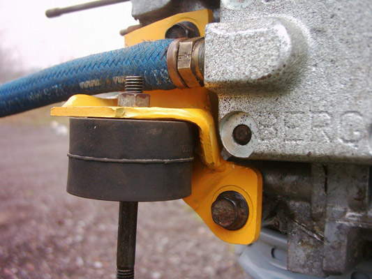

A full flow cover and modified engine mount.
(IMG:http://www.914world.com/bbs2/uploads/post-4-1082313177.jpg)

DNHunt   You can't full flow the stock pump as far as I...   Nov 9 2008, 07:43 AM
davep   Exactly how do you define "full flow"?   Nov 9 2008, 08:05 AM
Joe Ricard   Why would you want too. Normally you full flow so ...   Nov 9 2008, 08:21 AM
DNHunt   All of the oil goes through the filter. With the s...   Nov 9 2008, 08:37 AM
