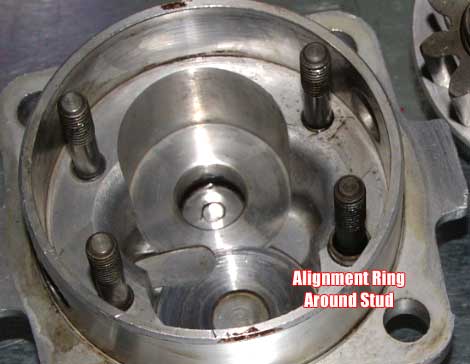

I was looking for information on the stock T4 oil pump and couldn't find anything helpful. So I disassembled on of mine today and took some comparison pictures.
Here is the stock pump:
Once you remove the four nuts on the back, you can use a 6mm x 1.0 bolt and a U shaped piece of steel to pull the guts:
In order to 'blueprint' this oil pump you would need to pull the four little studs, a small alignment ring, and then carefully mill the inside face of the body, thereby tightening the clearances between the flat sides of the gears and the body.
Schadek and Melling pumps are much easier to 'blueprint' because you can simply deck the face using something as simple as sandpaper on glass.
The stock pump does match up with the oiling bores in the case much better. Here is a stock pump. If you look closely, you can see the small variance: the case hole is slightly smaller than the pump hole.
Here is the Schadek pump body. Notice the much larger variance.
Finally, here are the numbers.

where is/what is/ expand discussion on "small alignment ring". thanks

QUOTE(type47 @ Nov 9 2008, 07:26 AM) *
