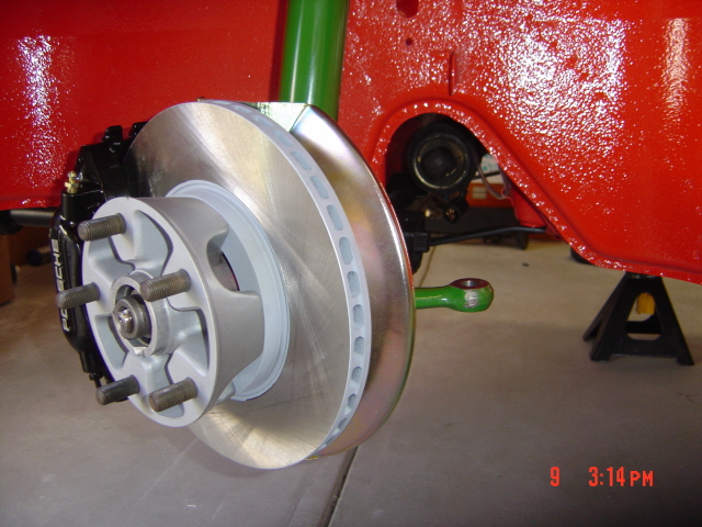

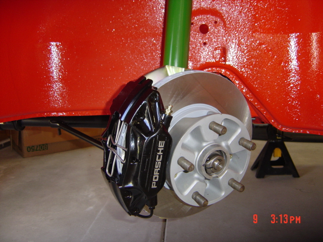

New front rotors with freshly powder-coated front hubs. New bearings and seals. I had to go with 18mm clamp-nuts and thrust washers due to the late-style Bilstein struts.
