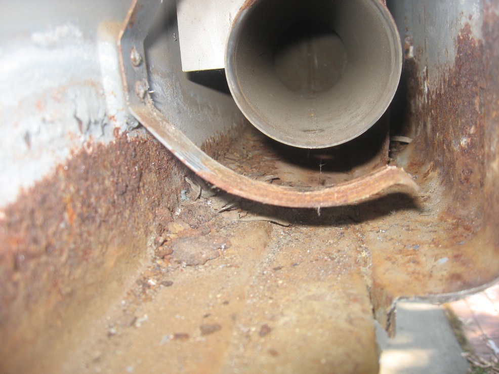

Been a while since my last post, but I've made some pretty good progress. Per the pic below, I've finished up the inner suspension console install.
Here is a pic of the passenger side long, open for all the world to see...

Next up are some other pics of the passenger side long and the state of repairs necessary...
