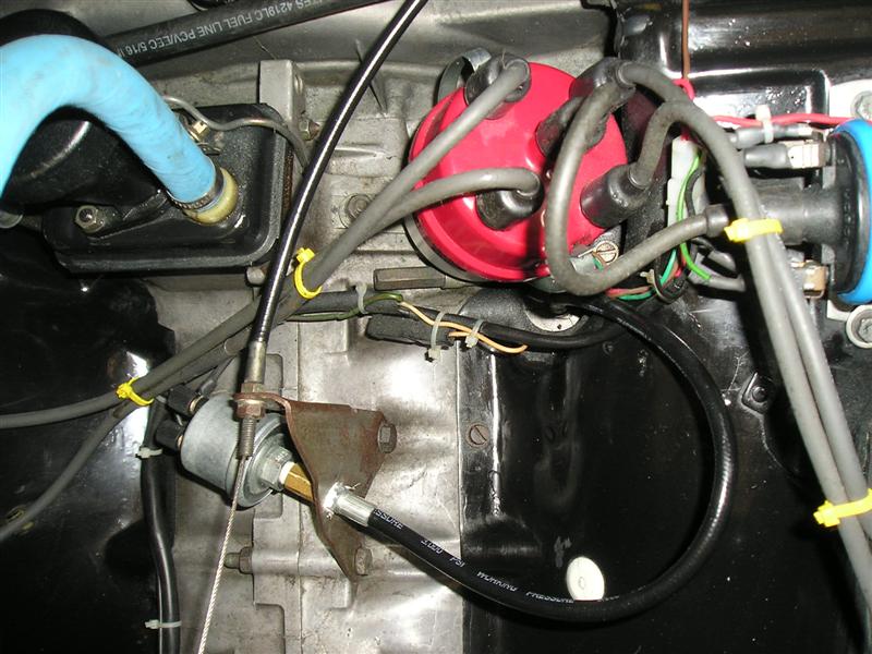

Sending unit well grounded ( I swear that is not teflon tape on those fittings)with high pressure hose, grease gun or aeroquip hose.

southernmost914   Sending unit well grounded ( I swear that is not t...   Nov 20 2008, 03:52 PM
jc914   THANKS SO MUCH STEVE thats exactly the information...   Nov 20 2008, 04:29 PM
