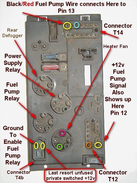

so I am installing a new bosch fuel pump for my factory fuel injection system.. Where my factory fuel pump used to one in the stock location, one of the mounting tabs is gone from a little bit of rust, so I am moving it to the firewall. And mounting it with sheet metal screws.. Any body have a manual fuel pump switch wired up so if that relay crap decides not to work I can just flip it on with a switch.. where do you have it mounted and how do you have it wired up ?

Dave I am not looking to hack I am looking to fix the problem, as I am the new owner the I am fixing the problems the car is not a junker it is from SILLYCON Valley I would like for the system to work as it came from the factory but if it decide to give me problem during a trip I would like to have the option of manually controlling it. Thankfully I changed the pump and lines they where pretty nasty..
The relay for the fuel pump in the hoto with a working one sill no pump any ideas of things to look at next ?

Dave_Darling   There are two relays that control the fuel pump. ...   Nov 22 2008, 04:41 PM

markb   As Dave stated, if the board goes bad, having the ...   Nov 22 2008, 05:08 PM
r_towle   get two new relays. Put on in the correct socket f...   Nov 22 2008, 05:20 PM

Spoke   Most folks don't do a manual switch because it...   Nov 22 2008, 06:07 PM

Spoke   No I have not tried that yet what do I do take a...   Nov 22 2008, 06:28 PM
markb   There's a ground post in front and below the r...   Nov 22 2008, 06:25 PM

bperry   I put a wire from tb4 to a ground when I put it...   Nov 23 2008, 03:32 AM
Spoke   Pin II and IV are tied together and are +12v whil...   Nov 23 2008, 08:22 AM

Dave_Darling   Which fuel injection system does your car have? T...   Nov 23 2008, 06:44 PM
