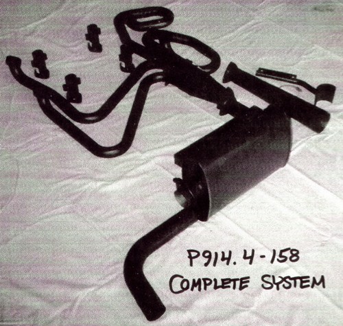

Here is Paragon products complete system.
This is a basic and well tested 4 into 1 (4-1) system.
The muffler is a simple hush thrush eight cylinder muffler with a custom tailipipe to fit through the lower rear valance.
The megaphone (cone shaped piece on the right of the muffler) would be bolted on to replace the muffler to make it really loud...
This system comes with stub pipes...the little short pipes that are in the top left of the photo.
the stub pipes bolt to the head, then the header bolts to the stub pipes.
The stub pipes make it alot easier to remove and replace the header and not disturb the head studs...which tend to come loose if you mess with them to many times.
Rich
