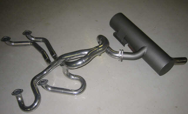

This is the Tangerine Racing (CFR) Chris Foley header.
The is the 4-2-1 header which scavanges better than the 4-1 header.
This systems also uses stub pipes (see a trend there)
Rich
