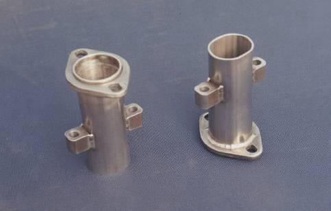

Finally,
here are the Tangerine racing (CFR) Chris Foley Stub pipes.
Rich

r_towle   This is the Tangerine Racing (CFR) Chris Foley hea...   Nov 23 2008, 06:26 PM
r_towle   Now, The primaries are all bent all over the place...   Nov 23 2008, 06:30 PM
r_towle   Finally, here are the Tangerine racing (CFR) Chris...   Nov 23 2008, 06:36 PM
