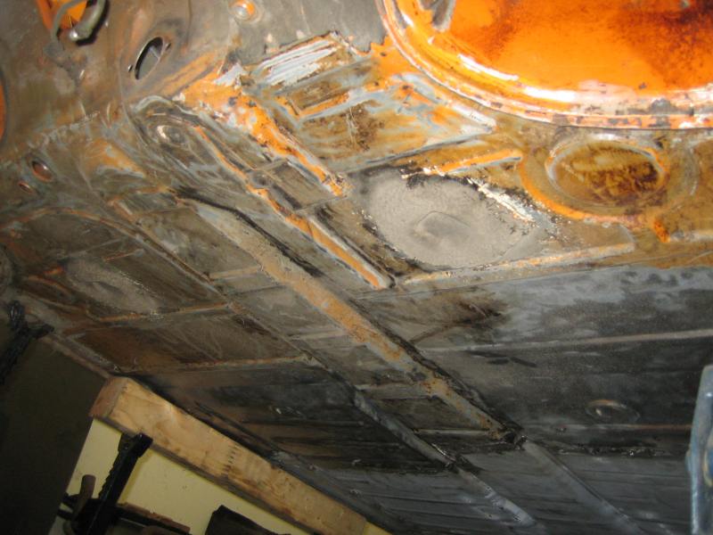

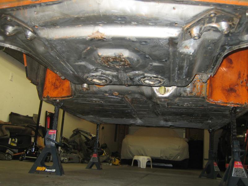

I was going to leave most of the underside which I had not touched, then I found that in a lot of places the underseal was pretty thin and just scraped off with little heat and in some cases just pealed away. So I got sidetracked from where I was at and started the messy and time consuming job of cleaning the underside.
For the moment I am thinking epoxy primer and then coat with some tintable bedliner, anyone have any experience with the bedliner?
Here is the underside after I removed the underseal and ready for some stripper.
After final clean up, little bit more to do around the rear a-arm mount but apart from that, pretty much done.

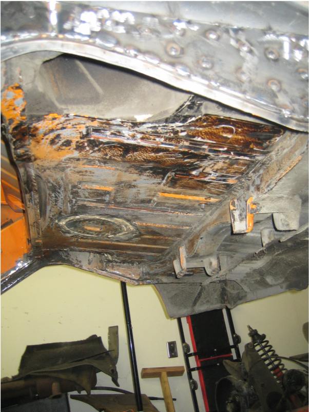

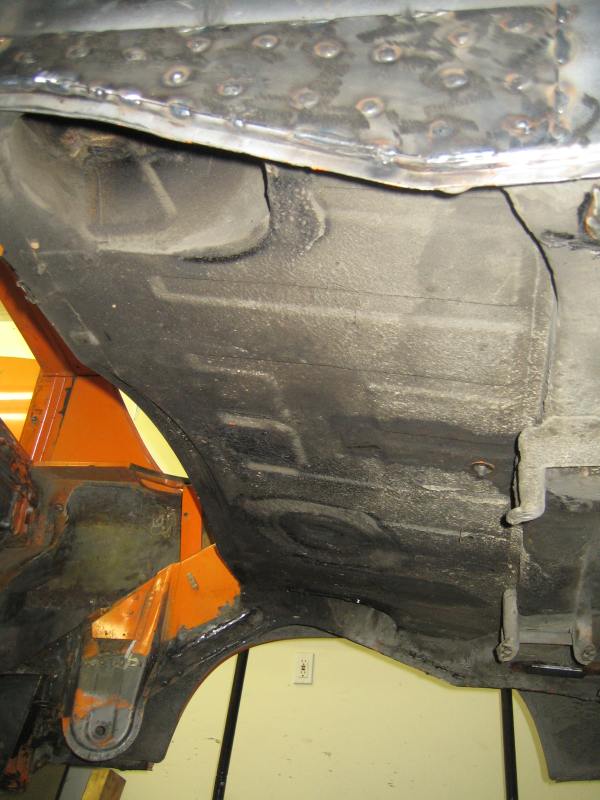

Now started on rear and this area is turning out to be more work as the underseal is in general thicker. Before:
After removing some of the underseal, taking a break now to rally some more enthusiasm.
