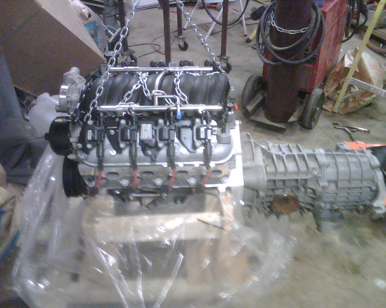

I am using this pedal because I am using this engine:
This engine has a electric servo motor that moves the throttle plate.
