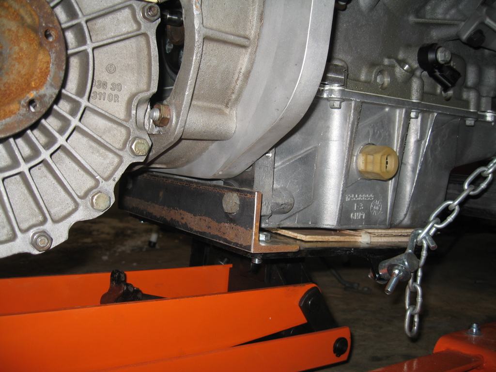

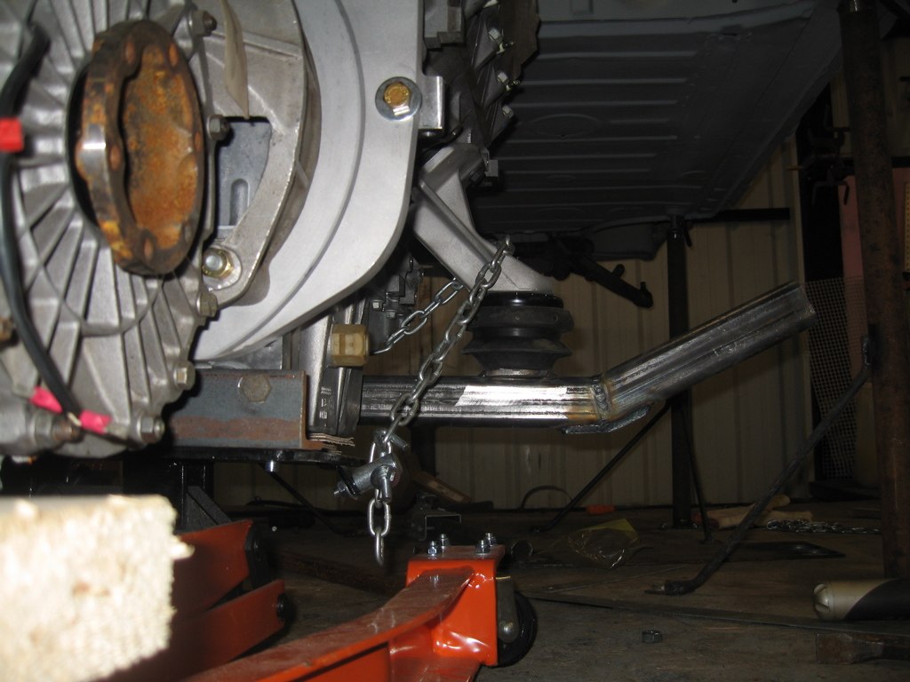

You're balancing the engine/trans on that jack, and going that high? You are a brave soul indeed! With the front suspension in the car, the engine/trans will not lift the front. Otherwise it will.
With the 930 in the normal non-flipped position, you may find you have to position the motor rather high in the chassis to keep the axles from endind up with too much angle. It's the same thing I ran into with my 6 speed setup. It's surprising how much room you gain with the motor in a lower position, but I suppose it's a moot point. The Corvette dampener does give you more room mostly because it moves the accessory drive closer to the motor.
I made up this lift for the engine/trans; it's only 4 1/2" collapsed so that I don't have to jack the car very high to wheel it under.
Andys
You're right, this situation was a little tenuous.
However, I like the fact this Harbor Freight 2000# Transmission Jack can:
1. Support the weight.
2. Can be tilted right/left, fore/aft.
3. Is fairly wide and seems stable.
4. Was bought on sale!.
What I did to make this a bit safer was bolt a piece of angle iron to the stand and the engine. This way the tilting is well controlled with no sudden sphincter loosening moves.
