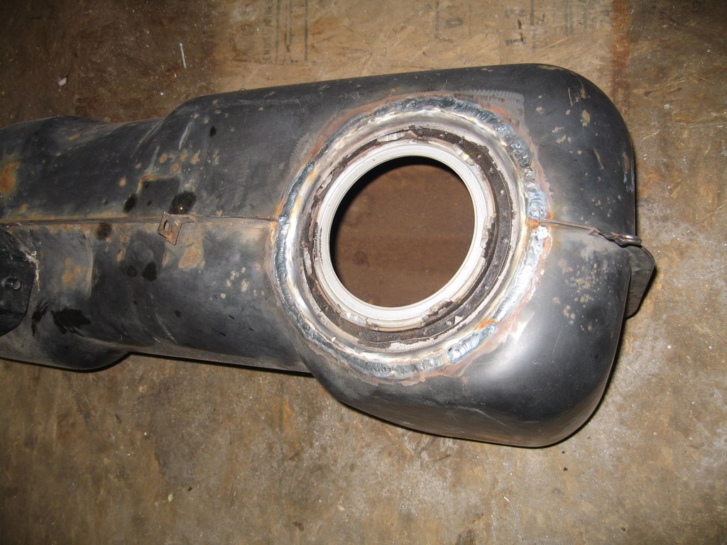

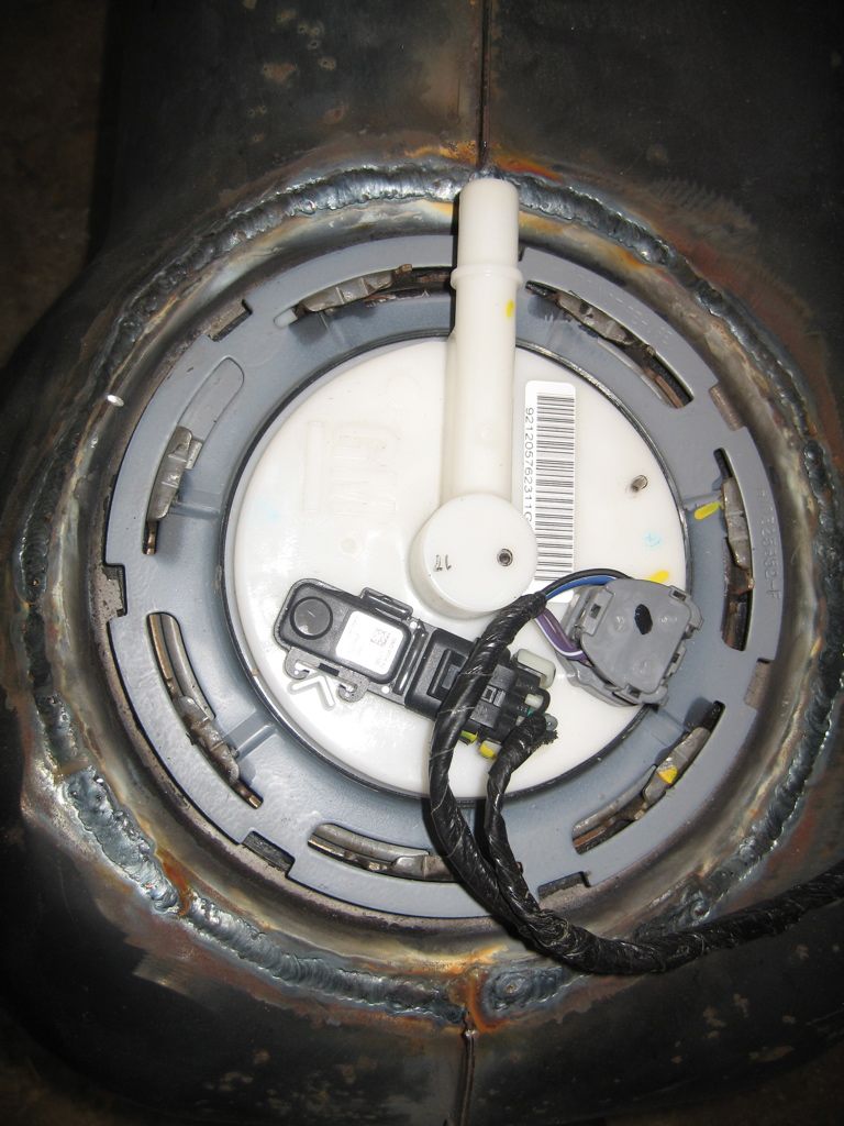

Cut the top fuel pump flange out of a Pontiac GTO tank and welded it into a 914 tank. This is done as I am using a GTO engine with it's fuel injection.

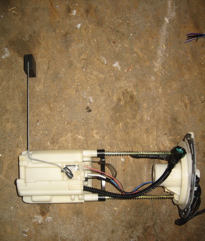

It will be for this pump which incorporates a reservoir bucket, the pump, pressure regulator, filter, and a sender. To make it fit I had to cut out the reservoir bucket out of the 914 tank which is removed by drilling three spot welds out of the tank bottom.
Here is the pump in the tank. A little bit closer to done today!
